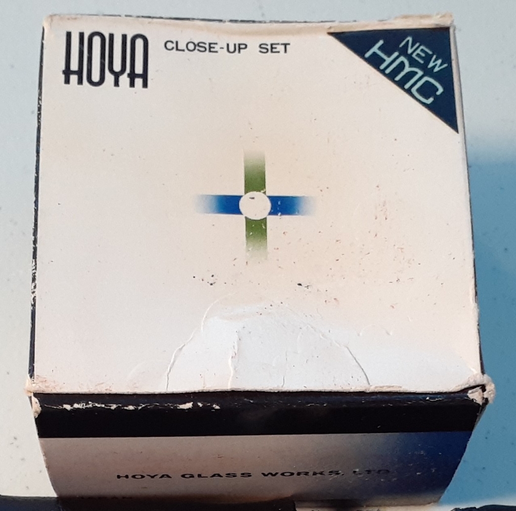

When I got the camera, it came with a couple of extra lenses and some filters. Pictures are just to show them. I don't see myself using anything than what's already attached, though.
