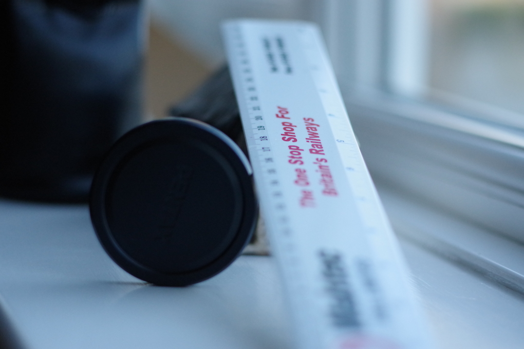

You can see that the lens is focusing at 18cm, 3cm behind where it should be.

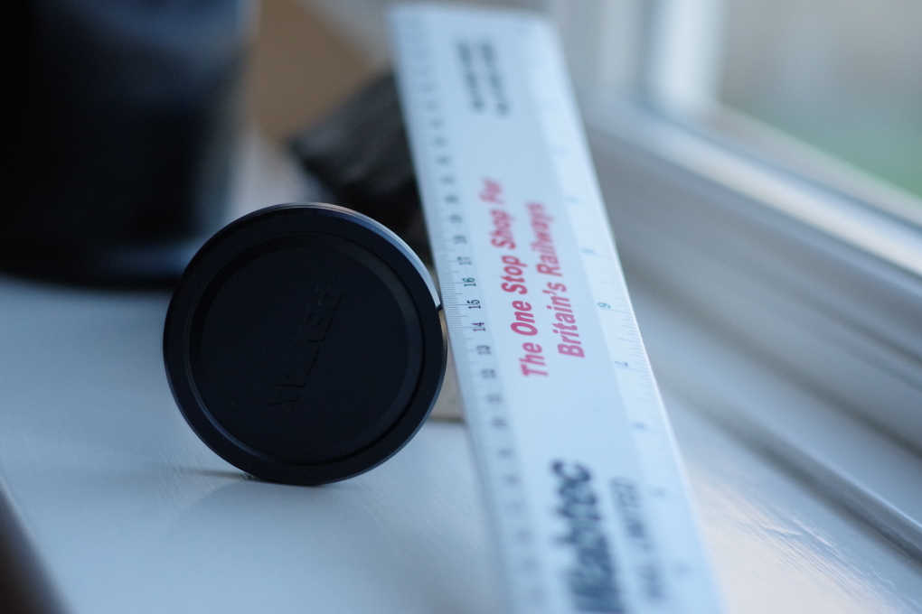

I then adjusted the AF Fine Adjustment to +7 and success the focusing is now sharp at 15cm.
This is the first time that I have found a lens to be this far out, particularly with it being a new Limited.
