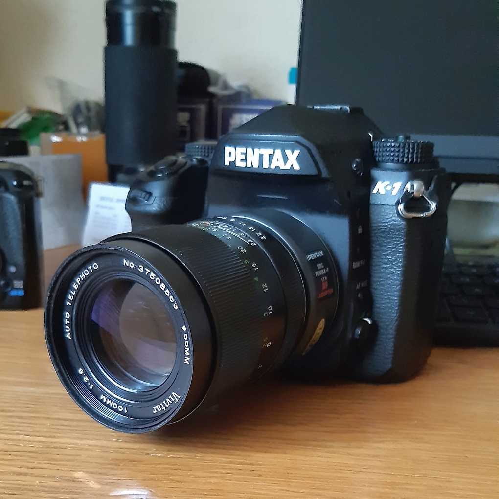

Here is an M42 mount Vivitar 170mm auto focus lens on a K1. It works perfectly.

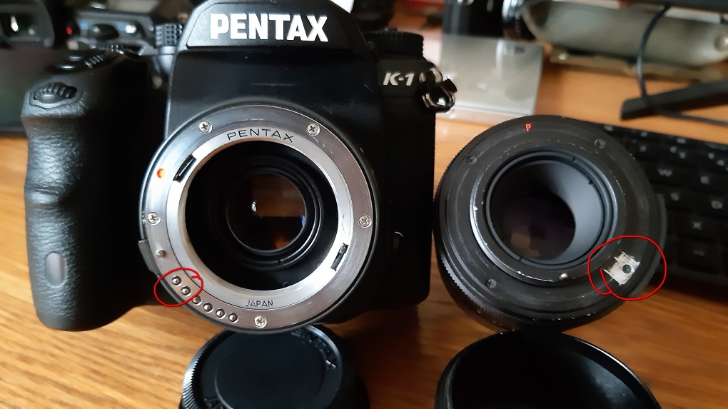

If you want to extend its usefulness you can convert many M42 lenses (and others) to AF by making the same modification as that needed to make the Jessop A series extension tubes work properly - you scrape off some of the black paint so that the rear flange of the lens shorts out two of the contacts on the adapter.

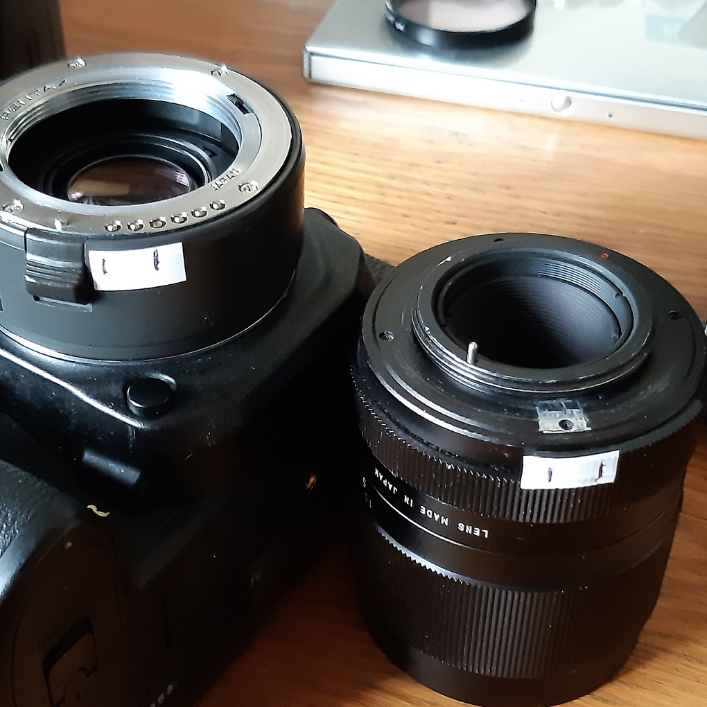

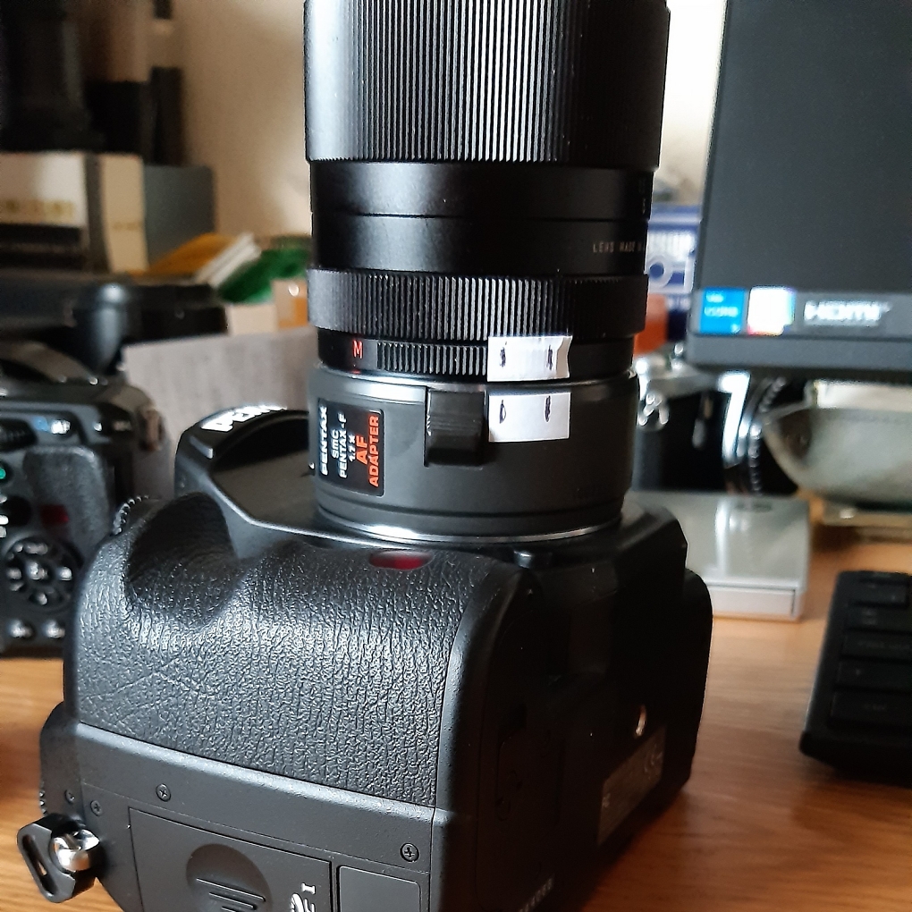

The problem is that the lens clearly rotates when it is screwed into the adapter, so how can we ensure the paint is removed from the right place?
Cut a couple of bits of sticky paper from a self adhesive printer label. Stick one on the side of the AF adapter and mark on it the location of the two pins nearest the red dot. Screw your chosen lens on firmly. Stick the second tab on the side of the lens and transfer the two index marks across. Now you know exactly where to remove the paint from.
The paint is normally hard and stubborn and can be quite difficult to scrape off. I use a small flat screwdriver. Depending on where the rear element is, be very careful in case your blade jumps!
