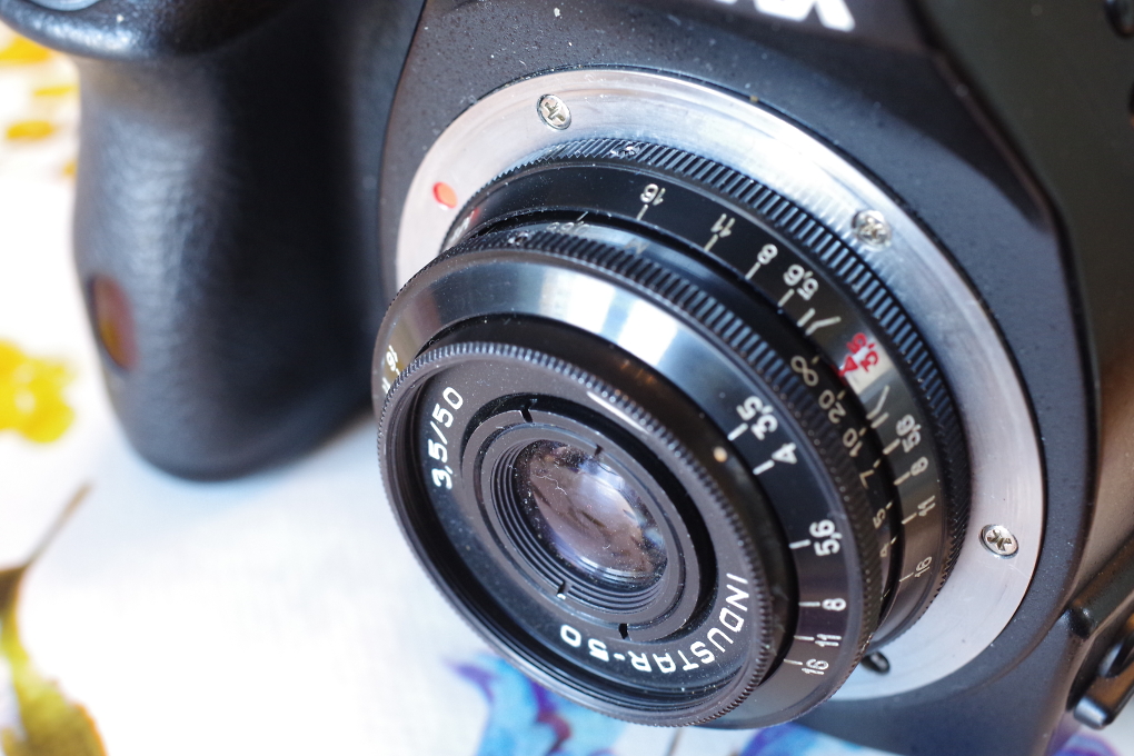

Things get more complicated when using a M39 lens, I have an Industar-50 lens with a M39 mount. To use this lens I have to fit a M39 to M42 adapter (non Pentax) and my genuine M42 to Pentax K adapter. Using this combination the lens and adapters can now be fitted to the camera but does not align correctly. I don't know if a genuine Pentax M39 to M42 adapter is available, but if this exists perhaps the lens would have aligned correctly.
